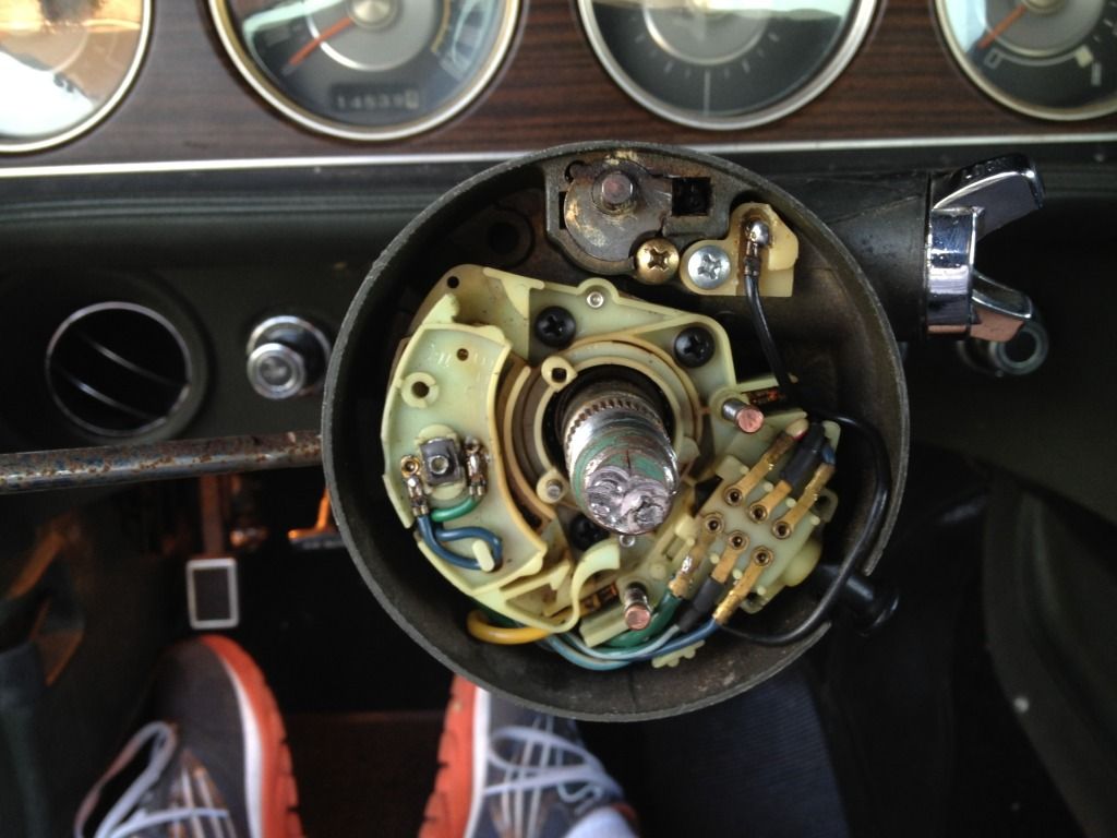

I'm in desperate need of a '70 turn signal switch. Mine ive soldered on to keep it functioning, this time its shot. WCCC seems to have the best one out there but they have bee out for some time. Any other sources for one? Also, mine is a '70 but has a straight peg for a flasher. The 70's Ive seen online all have the arch shaped button for the switch. Is this correct?
Also, some pics of '70 switches has the horn contact posts next to each other, mine they are not. Does this matter?

Sounds to me like you have a '69 switch. Do you have a column ignition lock? Does the peg unscrew? You are correct about how the '70 switches appear. Looking at MU's listing, the '70 switches are expected early October: http://www.mustangsunlimited.com/itemdy00.asp?T1=F2339+01 I would figure out for sure which switch you have before I ordered.

So heres the deal about it being a 69. I though it might have been switched when I first noticed the "peg" but the more I looked everything else was 70 correct. The '69 has 3 wires to the hazard switch, mine has 6, like the 70. My peg also does not unscrew. Its one piece.
