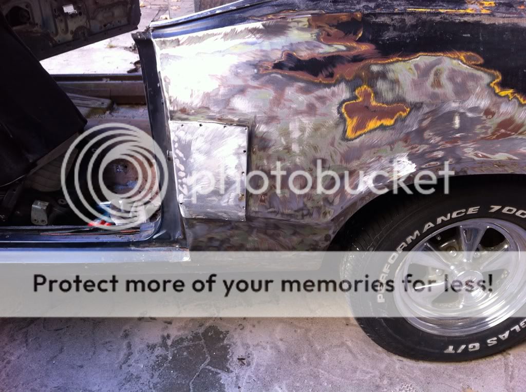

This is what I found last year after media blasting, Who in their right mind would think this was ok?:eek2:
4,115 Posts
The person who did it. I bet they did that, painted it and sold it for a profit.
41 Posts

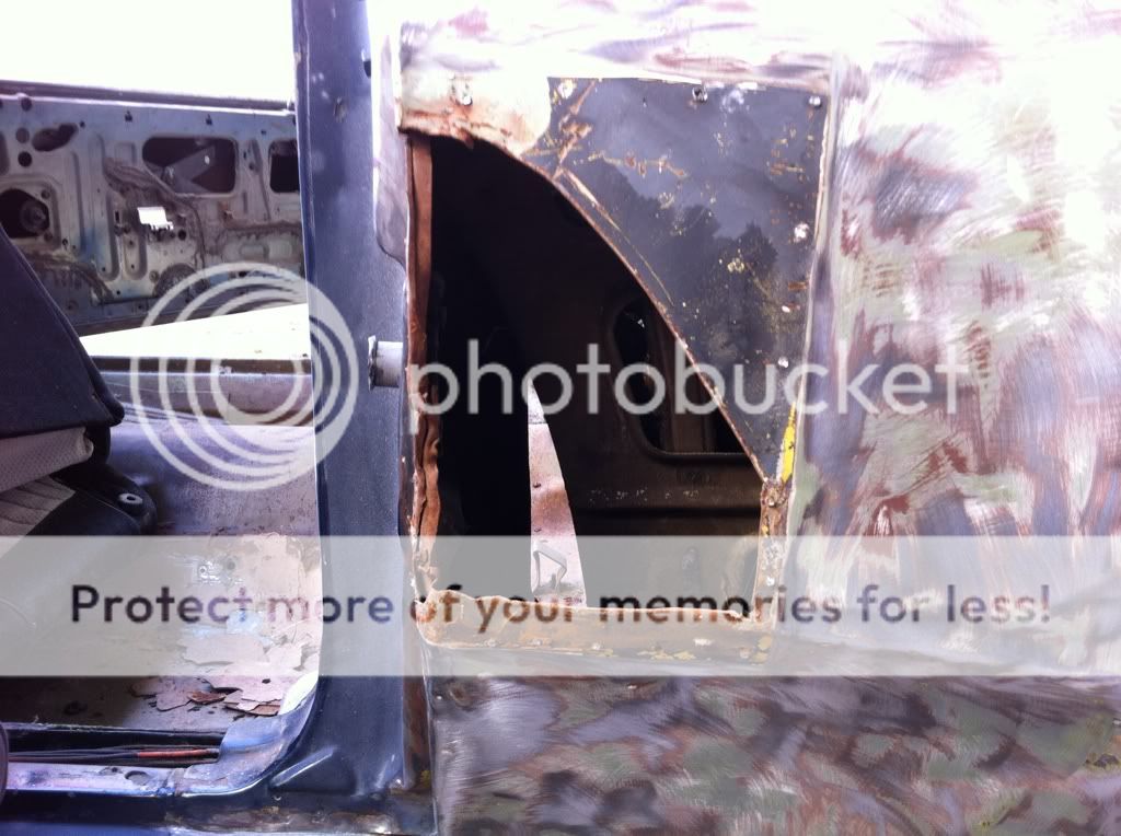

Was probably the same guy that did this to my Cougar:
Note the Bondo over the sheetmetal that was screwed on top on the rusted out floorboards:
Which will be fixed (thanks Don!) with this:
Not defending what was done, but every person is different and skill levels vary. When I was 18, I pop riveted sheet metal in to repair rotted out quarter panels (after proper prep) and did body work over that. It was what I had available to me and it worked (for a while).

Pop riveting in/on new metal was the extent of my body skills back 35+ years ago. I even bought a '72 'vert convertible parts car that had new quarter panels hung on it by a professional body shop some time in its life using a double-row of rivets! Then I tried my hand a brazing on body patches, saving the actual stick and gas welding to structural repairs. This was before the days of cheap/accessible MIG welders!!! Now, of course, everything I do will get done that way - although nowadays many body shops are using structural adhesives (glue)!!!
I thought that too. However they repaired the floor by welding a 3/4inch thick steel plate over the previous hole. The guy told me he had it all done at a body shop. I think he got freaking ripped off, and so did I, But $800 was not bad for a running driving car.

yeah, back in the day the old pop rivet was the only low budget method available. Even a lot of shops didn't have a mig - hammer dolly/dent puller/files were the methods - cover it with bondo. Todays stud welder/pullers, cheap migs, pannel adhesives, have made a big difference.

Once I get back in town I will take a picture of it for you. However, I think that you are thinking it is a really big plate when in fact it is only about 9 inches by 9 inches, and it was laid over the hole and welded there. But thanks for being skeptical, makes things fun.
It's just so wacky! I mean who would have a hole and then say "this 9 x 9 piece of 3/4" plate would be PERFECT to fix that with!"? Stranger things have happened/been found I am sure but we'd love to see what you see!

I am with you on that after I yanked out the carpet I was like what the hell was this guy thinking? Not to mention the bubble gum he used to hold the radio knob on should have looked a little harder during the inspection before I bought.
