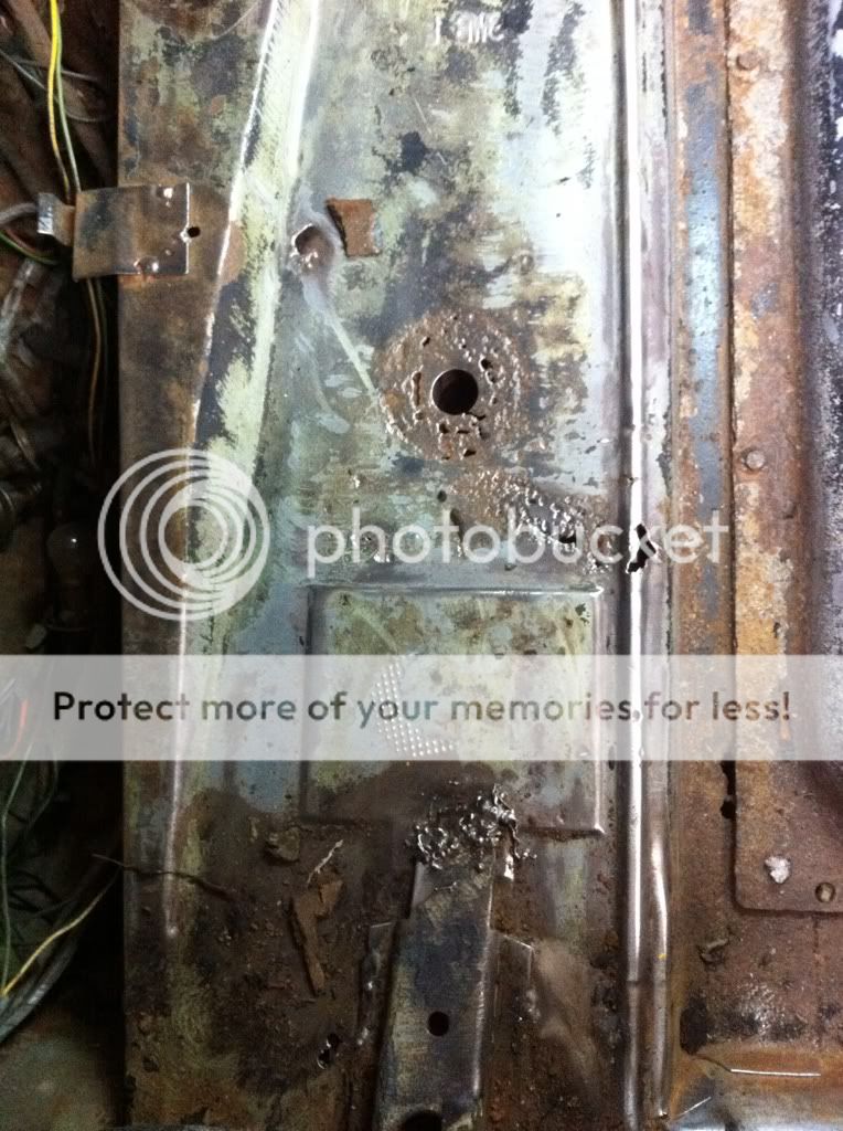

Mine is just really pitted around the drain hole as well as a few smaller holes here and there. Ideally I'd like to cut out a chunk and replace with a good piece of sheet metal that has the same pressing as the original.
Here's a pic..

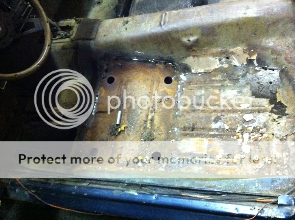

The floorboards on this car were wasted, so I'm happy to see that the trunk isn't too bad.
Here's how the floorboards looked:
other side after:

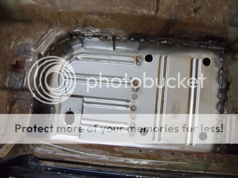

We ended up making both sides rather than trying to fit some repro part in. The hardest part was getting that round profile on the tank side to look right. Here's one of the panels we made before welding:
