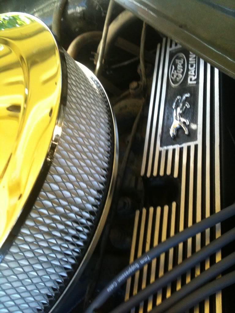

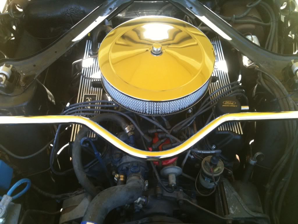

I have the Edelbrock finned aluminum covers on my 393W with World Products heads (valve cover lip is raised .300 inches over stock). I have H-S roller rockers, but no girdle so I can't swear to the fit...
The Summit Racing site says these will fit over girdles
Since I drove my car through two Cleveland Winters, the polished covers got a bit corroded due to road salt, so I painted mine with matte black paint then sanded the top 'fins', then clearcoated them with matte clear. Look good!

The cats I used came from a '79 Cougar side of the vinyl top in a wrecking yard.
Looks good! How'd you find the emblem?
