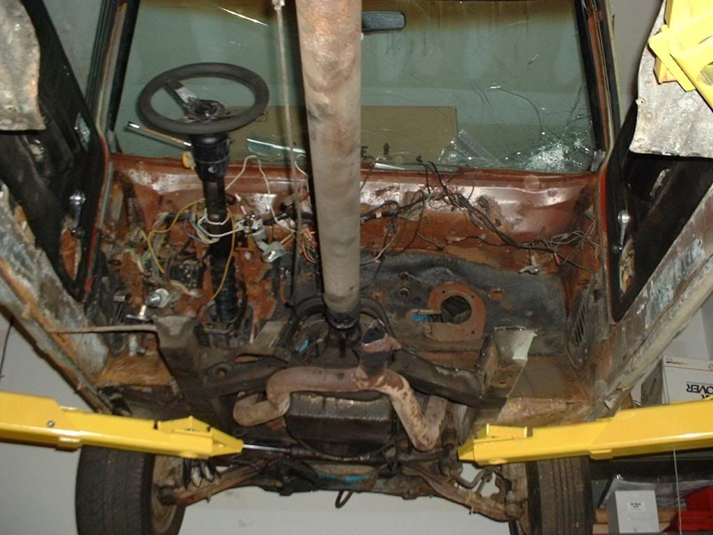

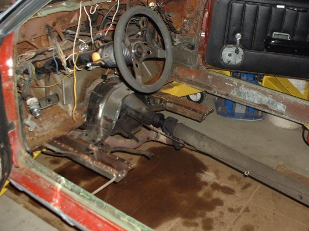

It's going good! Drivers side will be better than new in a short time...
Juls, At least your rust hasn't required measures THIS drastic!!
Safety Bar?!! We don't need no Stinkin' Safety Bar!!!

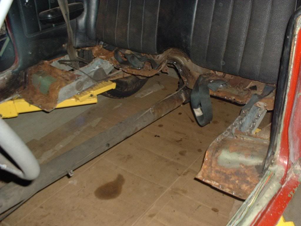

My 67 looks similar except the pans are in better shape but the firewall panels on both side are gone. Behind the rear seat where it slopes up to the trunk and wheel wells is munched and I haven't seen where you can get a repro piece to fix it. Anyone know of any? Surprisingly the fenders are all solid.I guess someone washed them out regularly.
Administrator
DANNY CLEMENS said:
Hey, a little Bondo and POR-15 and you're ready to go.
A LOT of welding, then the other side, a LOT MORE welding, a full-floor transplant from a Cali HT car, a LOT MORE WELDING, a cowl transplant from a Cali HT car, EVEN MORE WELDING, not to mention drilling out a GAZILLION (that's a lot!) spot welds along the way.
THEN the POR-15 and I am ready to go!!

Update: Donor metal "harvesting"
Now, here is the REAL "Flintstones, meet the Flintstones" car!! Harvest of donor hardtop floorpan in excellent (for an ECI) condition. Few easy repairs in flat areas and slap this sucker in wholesale to the 'vert.
Got the floorpan loose (drilling a bunch of spot welds and popping the metal loose, cutting of side seams, not needed for 'vert), exhaust from Y-pipe back off, E brake cable disconnected, rear brake line disconnected, driveshaft out, push the rear of the pan up and back close to the rear windshield, front clears the front frame horns, wrestle it around the Y pipe end, BAM!! It's out in one, nice piece!
Not for everyone (or more likely most), but sure beats a bunch of seamed in and incorrect patch panels. Not to mention that I can clean and prep an estimated full 1/2 of the undercarriage off of the car.

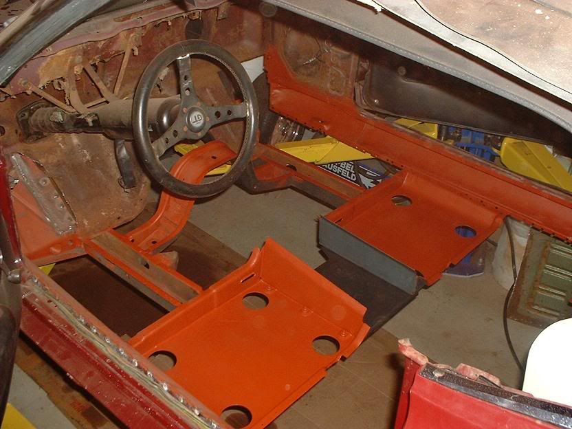

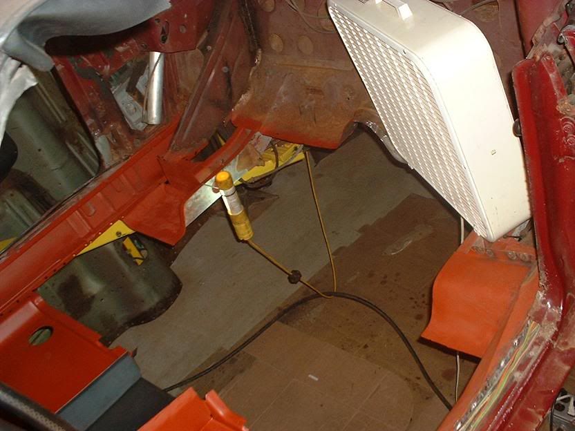

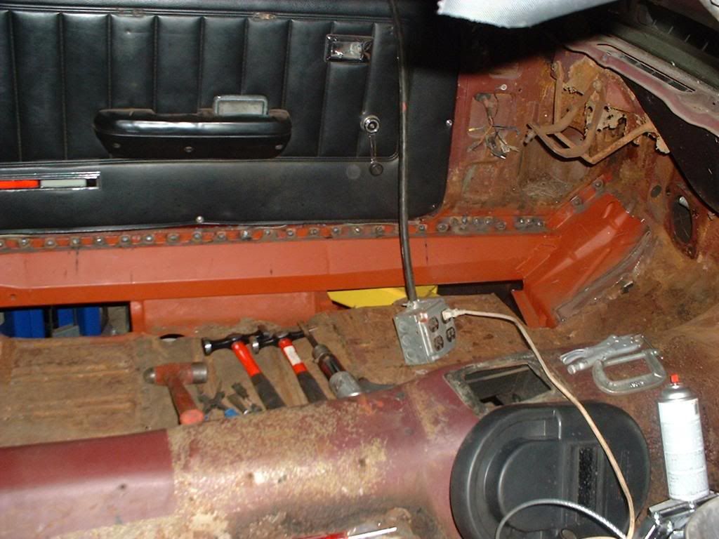

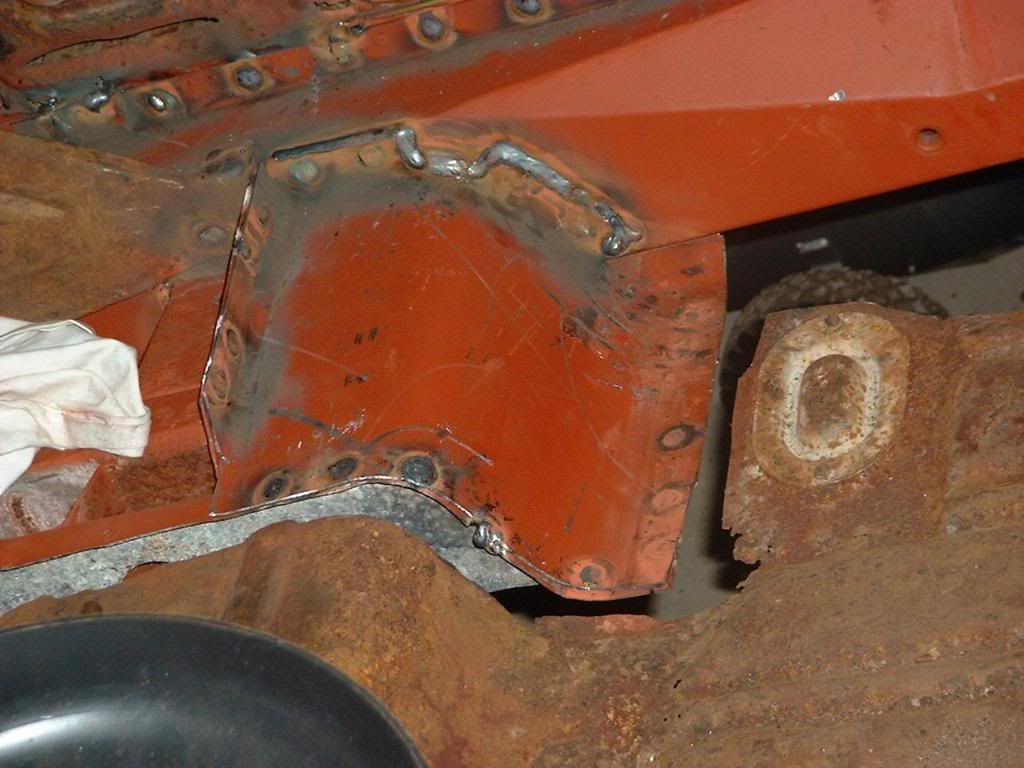

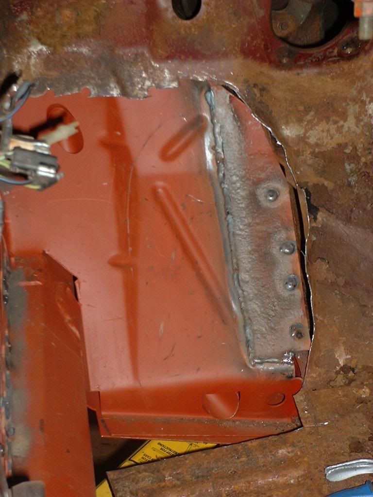

Gee, I forgot the 1st Inner Rocker "after"
Here's a few more shots after the drivers inner rocker and torques boxes were installed.

Neither when you have spent as much time as I have studying, planning and plotting my strategy. This is the hardtop, not the vert. Actually, it would not matter for either as the roof, inner/outer rocker and torque boxes are the real supporting structure (on a HT) and everything but the roof (on a 'vert).
Sunroof69 said:
I would be afraid it would just fold in half when put on a lift.
As you can see, the whole job was done on my lift (and what a civilized way to go about doing this!). Floor? You don't need no stinkin' floor! Either way "brave" and "idiotic" are complementary to an ECI, so thanks man!!
