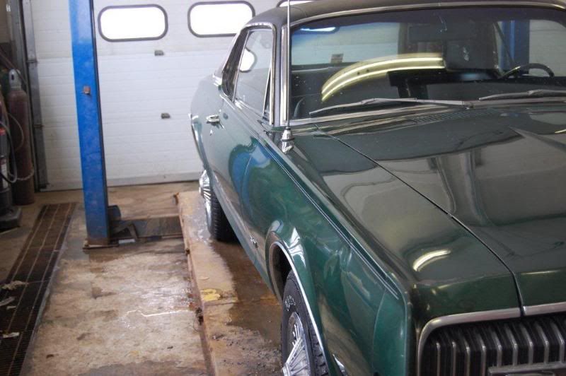

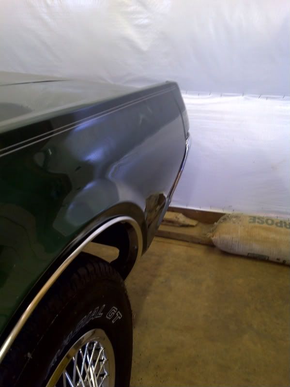

I'm thrilled to have this somewhat fixed..
For those of you that have seen the "before" in person, this is quite a change. I got a bunch of door dings and a hood bulge pushed out too. Can't say enough good things about a good dent repair guy! For those that have original paint and want to preserve their survivor cars or even touch up a boo boo with a repainted car, this is a great service. A lot can be done for a couple Hunskies$
The Before..
In process..

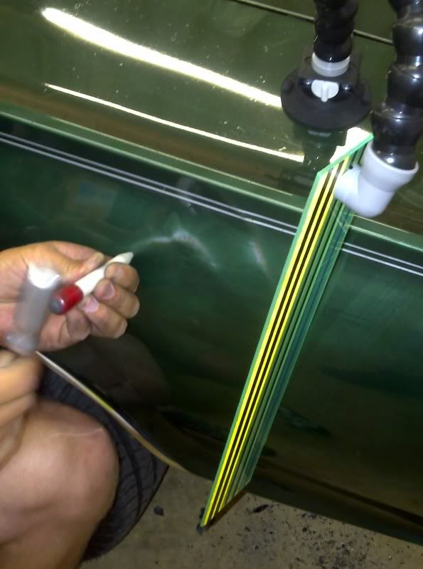

So whats the striped thingy mabob? (technical definiton) Some type of depth guage I would guess...? that was a fairly sharp edged dent....would be tough to get 'er perfect I bet. Didn't see the before but it must have been prety crinkled!
Steve,
See the "before.." captioned pic above. It's actually a good one of the before mess..unfortunately the buffer got carried away last year when the motor got rebuilt and the car was resurrected!
The lines give some sort of reference point/guage for measuring progress. They use these thick metal bars to rub it out from behind. LOTS of leverage was needed on this thick old sheet metal. The guys said "wow, my arms are tired"! As if they had not been doing this kind of work on old steel for a long long time ;)

The striped thingy is a light with lines on it so they can stare at its reflection in the paint and watch as they push the dent out. It keeps them from having to move their head back and forth trying to catch something in the reflection to see if the dent is still there or not. When you get to watch a guy who's really good at PDR work, it is pretty amazing.
