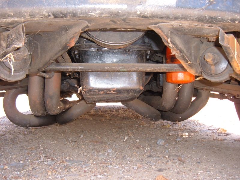

New Year's Update:
Still slowly collecting parts for the engine build as funds allow. I went with a Canton Aluminum 8 Quart Road Race pan with the needed pickup, and a POP'S Blueprinted Melling HV pump .
Originally, I was going to run a Holley 850 DP which is not a very fuel minded carb for a daily driver, so had been looking for a Vacuum secondary carb around the same CFM, and came across this NOS Holley 1,050 CFM 3 Barrel, this should be interesting.
