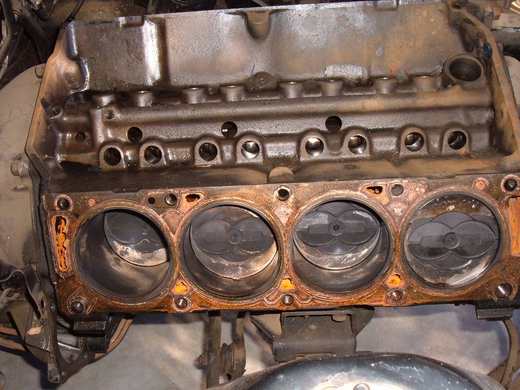

Things have not moved along as I would of liked, money has been tight but have picked up a few minor items.
I had gotten it into the garage some time ago, but until recently had not done anything to it.
I got the headers off and that took a lot of work.
The heads I was very curious about so those came off, and found out some interesting things. The No.1 piston has a nice indentation from where it was hitting the head, so I know which rod bearing went, and cyl No.5 & No.6 were sucking water from the intake manifold, indicated by the rust on top of the pistons.
http://s71.photobucket.com/user/Type4Unleashed/media/COUGAR/DSCF2719_zpslzbagka8.jpg.html
ouch..... she was certainly a hurtin unit!
