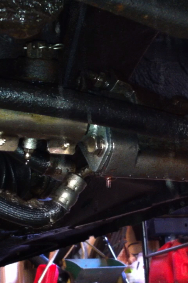

So I knew the power steering needed help when I bought this car yesterday, expected to have to replace the power steering pump and rack. That's what my guy said was behind the leaking. Here's a pic that tries to capture a drop of ps fluid falling:
There's fluid dropping regularly, fairly rapidly, from the bottom of the pump, and it ends up dripping to create two puddles. There's about 20 degrees of slack in the steering wheel, which is apparently where it was obvious to him that the rack needs replaced.
