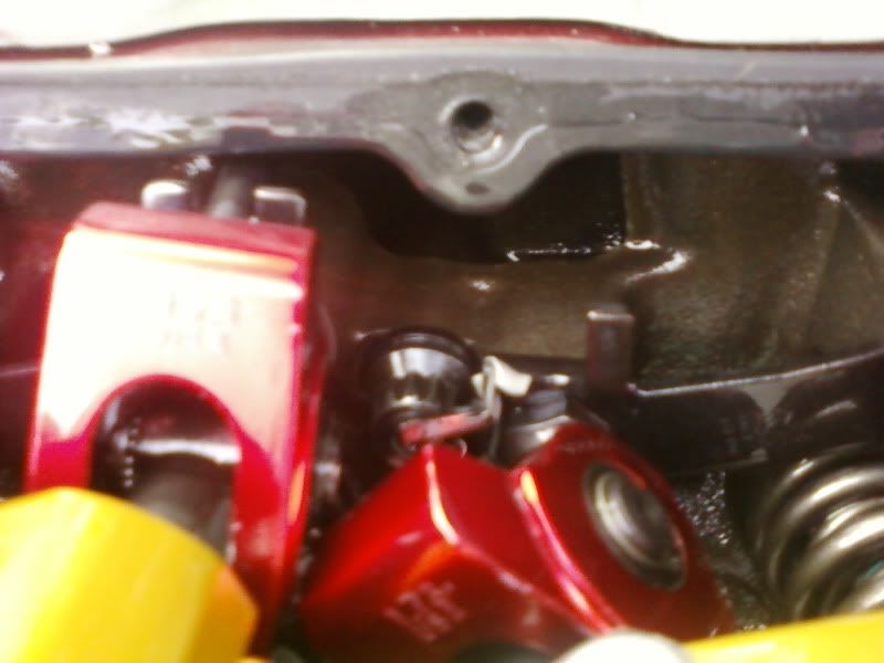

I get there and the guy that owns the house that it died in front of is out there looking it over. Talk to him for a minute, then get to work, with beer in hand. I pull the drivers valve cover and everything looks perfect. I pull the passenger cover and find this:

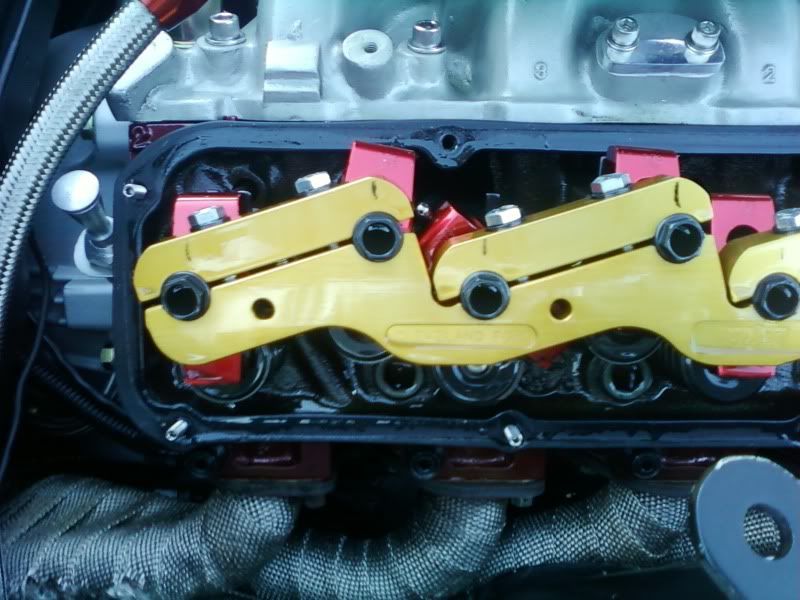

So I took the girdle off and unbolted the rocker. Had to pry the rocker out a little because it was wedged, and was actually holding the valve open a little.
I don't have a car trailer, and my driveway is up hill, so trailering or pulling was out of the question, and I wasn't about to let it sit there over night without me sleeping in it. So my only other option was to drive it home. Since the exhaust rocker was the issue, I had to pull the intake rocker too so it wouldn't continue to backfire. Then my concern was leaving the lifters in. They could get beat up if the stay in, but I wouldn't have any oil pressure if I took them out, so I left them. Since I was only a 1/4 mile from home I was hoping it wouldnt be much of an issue if I kept the RPM's down. I get everything buttoned back up and get ready to fire. I got her home doing no more than 2000 RPM (not easy with a 3800 RPM stall) and had to shut it down in the driveway because the garage was closed. I didn't want to leave it running while I ran in and opened the door (I really need to get some remote openers) and didn't want to start it back up. So I pushed it back in. Ever try to push a car that has a 4 pinion traction lock unit it it? Easy if you are going straight, not so easy even in the slightest turn. Of course my garage is on the side of the house, so I almost killed myself just getting it pushed in the garage.
After my walk (with another beer in hand) back to the truck to get it home, I take the cover back off. It appears the oil pressure held the lifters in place and didn't let them drop back on the cam once they were up, so my worst fear were relieved.
So, the guide plate is broke, the rocker is a little beat up (salvagable I believe) and the pushrod is bent. So what happened first? Either the guide plate broke and caused the angles to get off and let the pushrod fall out. Or the pushrod got bent and bound up against the guide plate. Either way, I at least need a guide plate and a pushrod. I am hoping that it was a weakness in the guidplate, if it was the pushrod first then that means I need all new pushrods.

Thanks CJ. Was yours just because of the guideplate? I am thinking that mine had to be the guideplate since it did it at low RPM. I can't imagine that the pushrod got bent at less than 4K. It didn't run any different after my romp, and was a good 45 seconds after that when it acted up. I just hope it was an isolated fluke and doesn't happen again.
1,884 Posts
Yes. An "ear" on one side of a pushrod slot broke off. This was with a set of Ford Motorsport guideplates on a 351W back in the eighties. Looked over the rest of the valvetrain carefully, and found another that was starting to crack. Threw those away, and bought a set of stock SBC replacements at the parts store. Came in a TRW box, as I recall. Never had any problems with those.

Just wondering, is it possible that the valve stuck in the guide? I had that happen in one of my (chevy, I know ugh!) race motors years ago. Luckily the valve only slightly hit the piston and did not do too much damage aside from ruining the valve and bending the pushrod. The machinist had left one of the guides too tight. I suggest trying to push the valve down and see if it is stuck. Also it might be a good to pressurize the cylinder with the rockers backed off to make sure the valve is not bent and is seating as it should.
x2 I like that thought! Maybe check the ridges on a few keepers to see if any have jumped out/in and show wear? I see Kevin's angle too though..... Look closely at the guides too....any marks where they may have rubbed it to much? I wonder if that girdle is putting a bit of pressure on any that aren't perfectly centered..? Once you crank that puppy down everything becomes as one and there isn' to much margin for error - nothing is going to give very much, which is the whole point as long as all the alignments are there. It sounds like your well within the tollerance of spring pressure so I don't think going to 3/8 PR will change anything really.
Another thought - how about checking the tips of the valves and the rollers now that you have run it a bit? --See if everything is contacting true/square. There may be enough marking to tell something - or put something on the tips to wear off and give you an opportunity to check it later....
Can you tell if the guide plate was bent up from the bottom or down from the top first? .... maybe there is a sequence you can follow to clue you in, or just a bad PR right out of the box - who knows.
5,279 Posts
You can loosen the stud and move the guideplate a small amount to locate the rocker arm over the valve.
I think you have interference somewhere. Look at the rockers carefully.
Don't risk salvaging the rocker arm, buy new. Save the old one for a spare. (The rocker beside the broken one looks wedged severely). When a rocker breaks all those little needles are circulating through your motor.

I just did a pressure test. Had to hollow out an old plug and rig up a hose to it, but did the trick. It is without a doubt holding pressure. You can hear some leak down, but I compared it to another cylinder and it was the same. It held pressure well enough that it pushed the piston all the way to the bottom of the cylinder. I also looked at the top of the piston with a mirror and a flashlight, no marks.
Everything is lined up just perfect. I spent a LOOOOONG time bolting and unbolting everything to make sure the rockers centered up just right. I am running lash caps on the valves and all of them show perfect wear. Shiny in the middle with a small strip of black left around the rims. No wear on the rockers anywhere, no eveidence of rubbing.
The leg on the guideplate looks like it was pushed over and up. Everything checks out to be just perfect. the only thing I can think of is a bad guideplate or a bad pushrod.
Like I said though, if this happens again, I will surely upgrade to 3/8 pushrods that are rated for 900 pound springs.
Maybe it was just a simple misalignment on the guideplate then....? hmmm sounds like everything is where it belongs then. IDK hopefully it was just a fluke.
