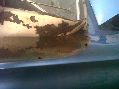

It's a clean driver, but there's some parts that will get my undivided attention!
This is looking up under the dask. Looks pretty good, but enough water leaked through here to ruin the floor...

Once inside, I took a good look at what I was starting on. All in all, a decent starting point for sure. There's a few obvious issues and it's been hit a couple times, but nothing that can't be remedied with knowlwdge, tools and time!
