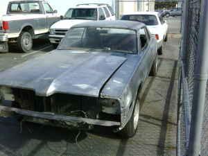

I thought I would take a moment to start a thread about my build (a recently purchased 68 Cougar). Just received my Marti Report this weekend and this was an original no-frills purchase. The only options listed are: C-4 Merc-O-Matic, E70X14 Wide Oval Tires, White Sidewall Tires, Power Steering, AM Radio. With this being as basic as a Cougar could have come, I figure it is a great opportunity to make a Custom 68 Cat!
The PO was kind enough to have it sandblasted \ sanded about 90%.
The 302 that is in it appears to be strong running (not sure on originality), and the tranny is believed to have been rebuilt in 2002. So that will remain the power plant for this project.

Today, I was able to get a good start at fitting the rear passenger floorpan - hopefully will finish fitting tomorrow and start fitting drivers rear.
Found my front rims are 14x6.75 - we like the rims, but I was going to do a SSBC disc brake conversion (but it requires 14x7 rims). Going to have to give the manual disc vs manual drum brakes more thought...
