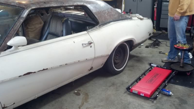

The back story on this cougar. in 1972 my wife's grandmother on her mothers side purchased this car. Before she passed away my father in law asked if he could buy the car from her, as he had always loved it. Well she decided to give it to him and he has had the car since the mid 90's i believe. My wife always hated this car as she was forced to drive to to school as a kid, but now she is very excited to keep it in the family. My Father in law asked both of his sons and they didnt want to take on this project. The pictures of the car he sent to them all made it look horrible, well I am a risk taker so when he asked us we both agreed to at least take a try at making the car right.
My first impressions of the car when i got it, it was a lot better than I expected, the body is really straight just a few issues on the doors and one quarter panel. I knew the roof would need to be replaced. Here is a quick video of the car when i first got it. That was back in November 2012.

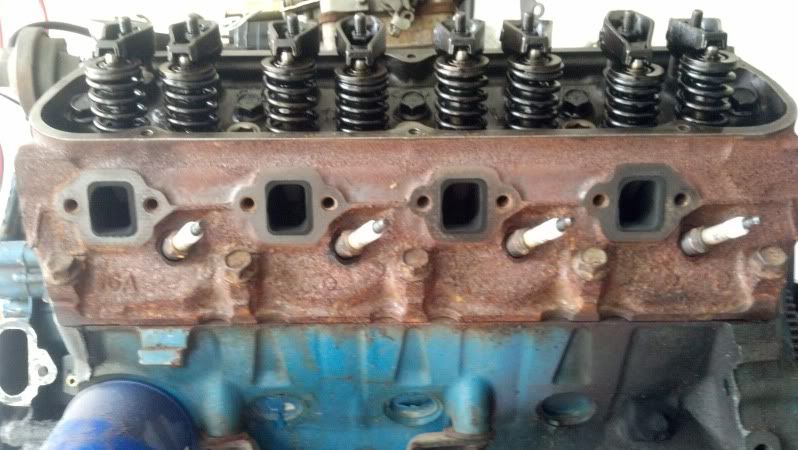

here are 1975 heads on a 70 block, long story short in the 90's my father-in-law had the original heads reworked and they got screwed up, so he threw these on them for the time being.

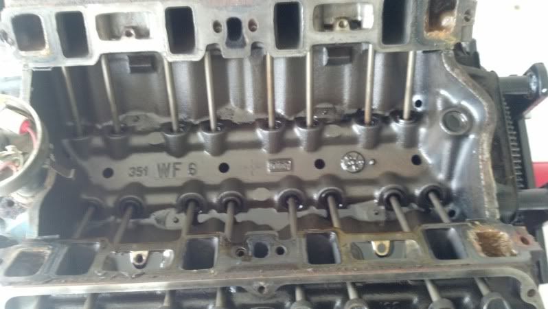

here is the lifter valley, this is exactly how it looked when i took the intake manifold off

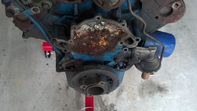

and finally the water pump, im no mechanic, but how does that happen?
See less See more
...and finally the water pump, im no mechanic, but how does that happen?
If your water pump has a plate on the back of it and you do not see the impellor (I am not real familiar with Windsors), then the gasket between the pump and the timing cover allowed fluid to leak into the cavity where you see the corrosion. If the water pump has the impellor exposed when you look at the back of it, then the cavity is wet and the corrosion occurred because of running water without antifreeze or the antifreeze was very old.

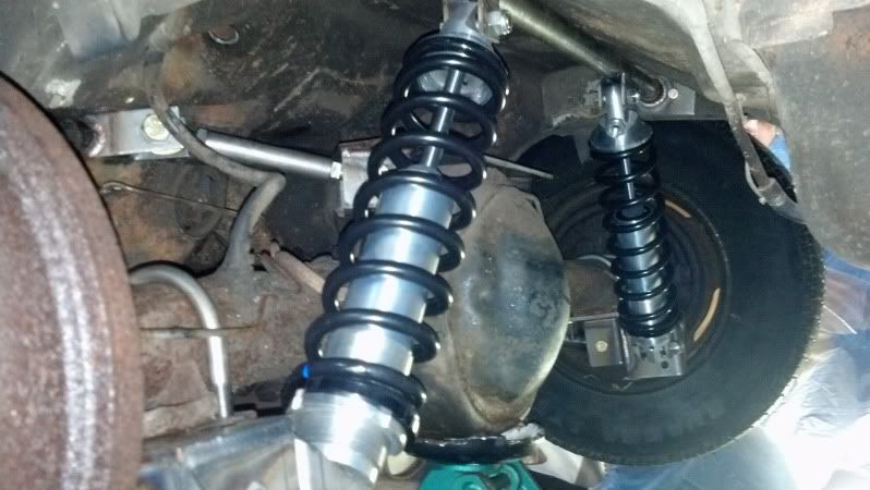

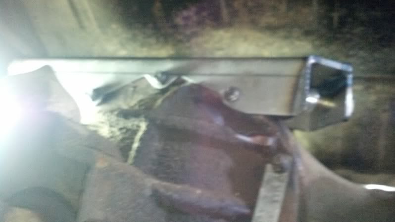

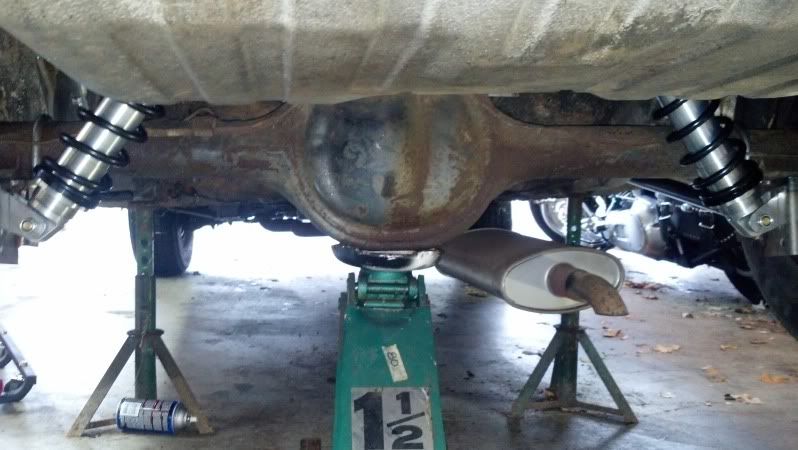

Back in January when it was 6*F i decided it would be a great time to install a rear 4 link from Rod and Custom! here are some shots of it. I will paint it all and redo the undercoating after body work is done, also clean/paint the entire rear end.
Rear housing top mount
everything all buttoned up
rear is slammed for now, im sure i will raise it up a bunch to get the look right

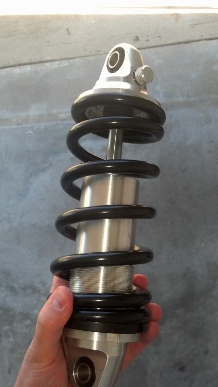

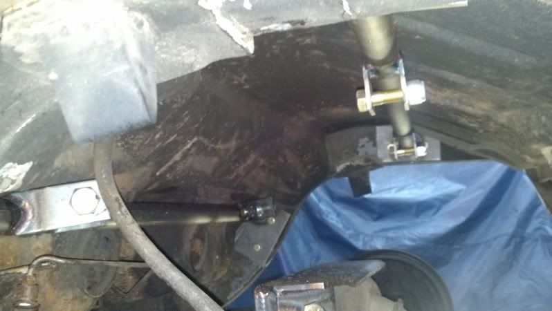

here is a preview of what is going on the front
a full coilover package, disk brake conversion, and rack

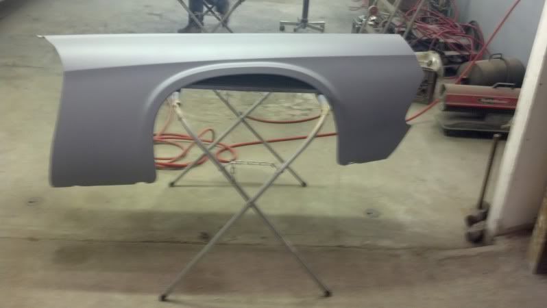

went to the shop today after my lunch meeting was pleasantly surprised with the work that they have been doing.
one of the front fenders all primed notice the side marker is shaved

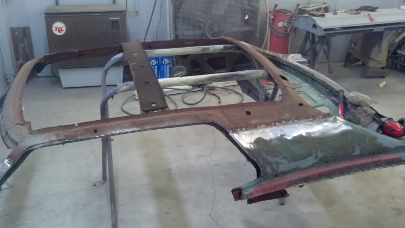

next we have a great view of the doner roof section after it was cut
