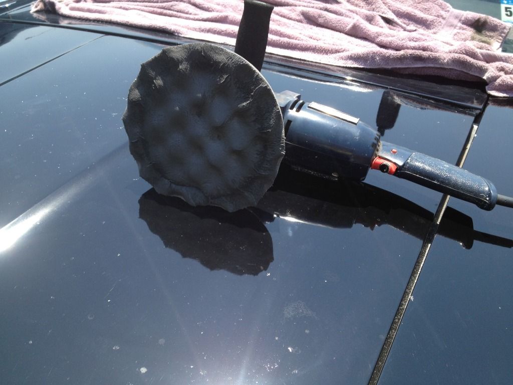

- Wont be getting body or paint soon, but will polish whats on it

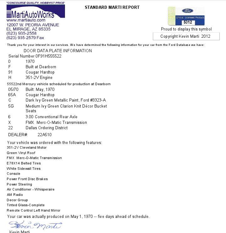

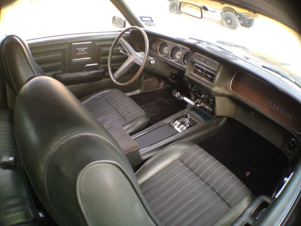

The door plate is rubbed off, and I wanted to know the factory color names so I ordered a marty report. Base model cougar with decor group interior. Dark Ivy Green exterior / medium ivy green interior. 351 Cleveland, FMX...Looks to have been in the DFW area for its whole life.
After getting it home I spend countless hours just checking everything and really looking it over. What suprised me was how original everything was. Nobody hacked at the wiring under the dash and everything was in place in the engine compartment.

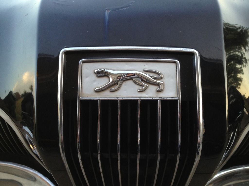

Having a bench grinder / buffing wheel has been a life saver! I was able to polish up the chrome and alumium background as well as paint semi-gloss black on the mercury lettering. This is how it turned out.
The bumper is by far in the worst shape as far as chrome on the car. Should be a good core, but it is high on our list of replacements.

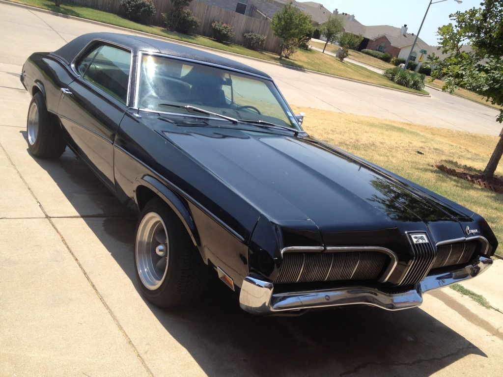

While I had the polish and paint out I cleaned up the nose. Headlamp covers will be next.

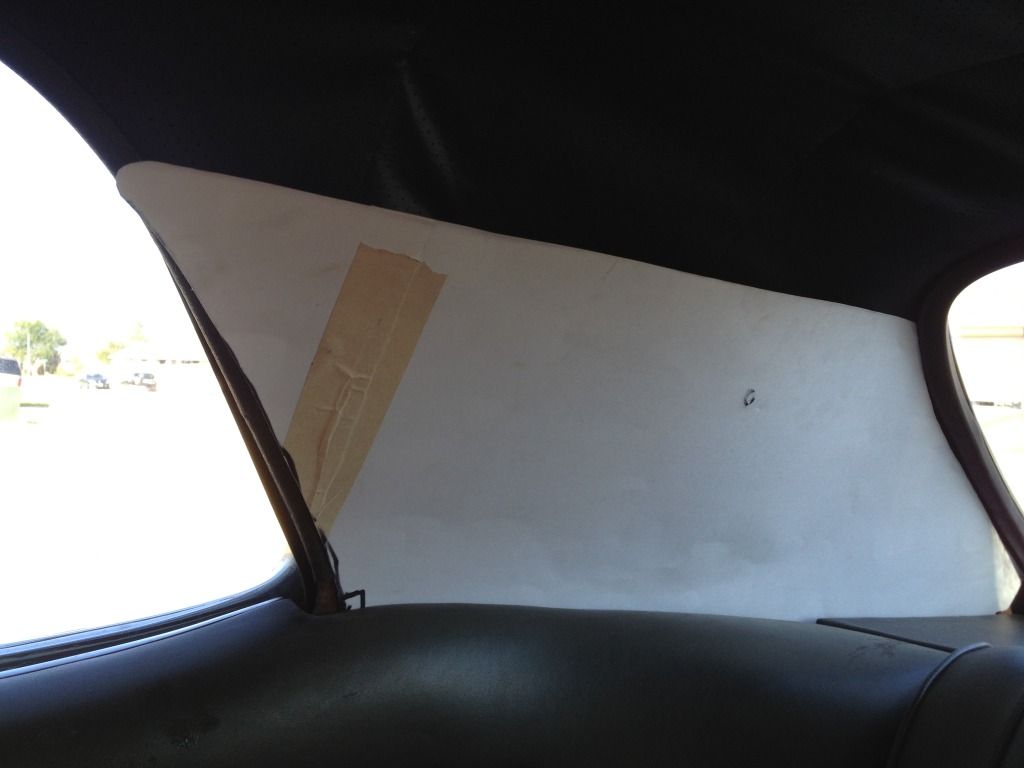

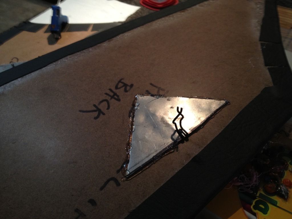

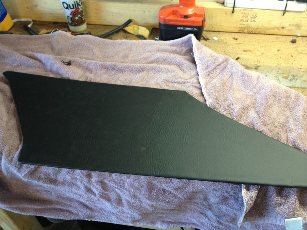

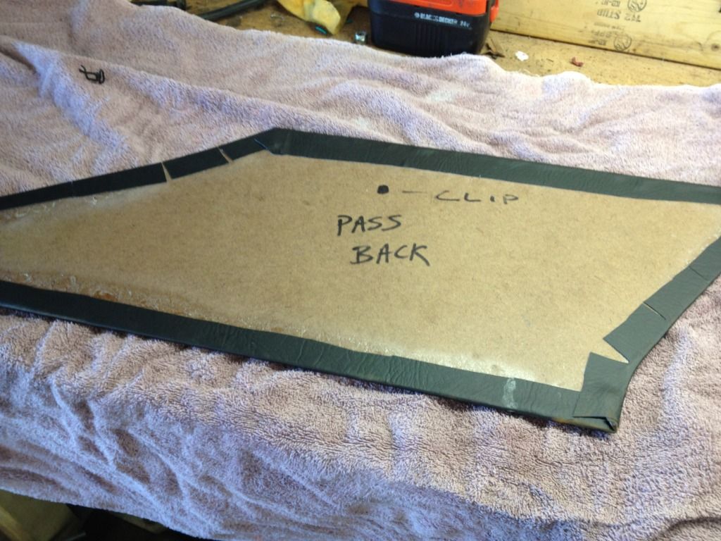

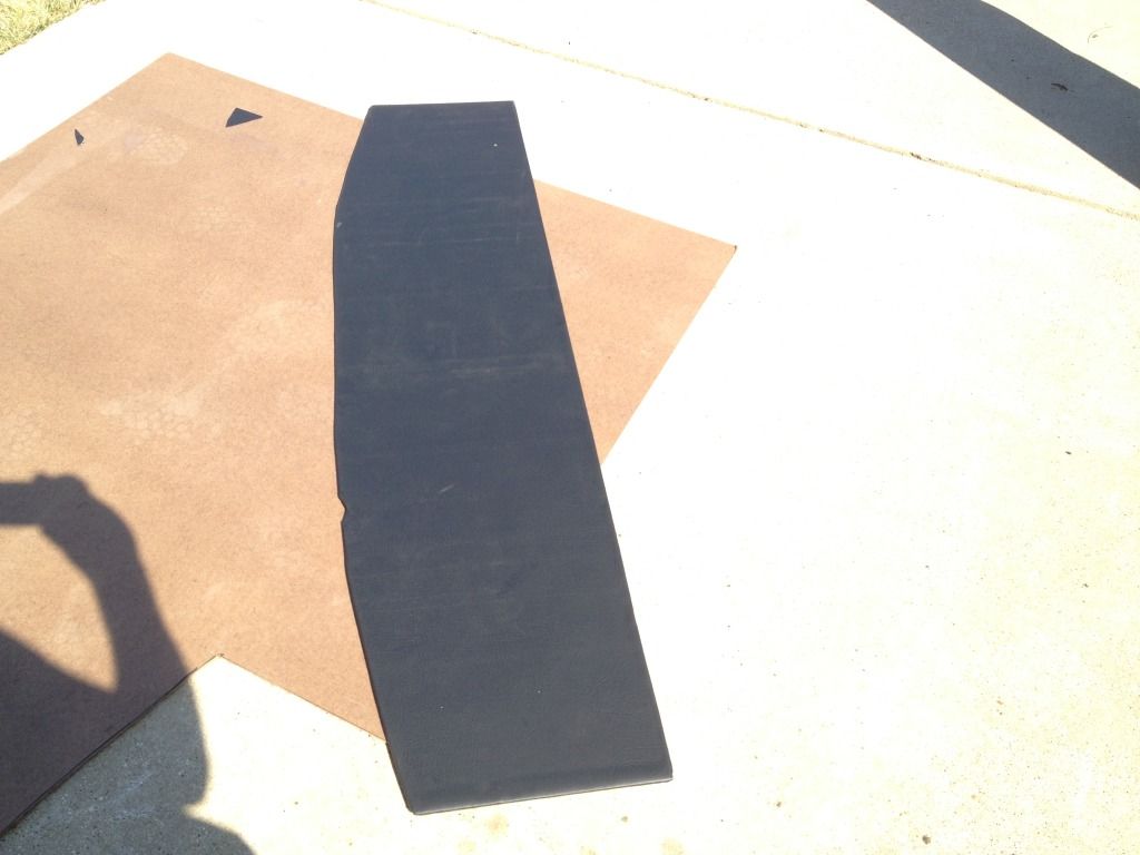

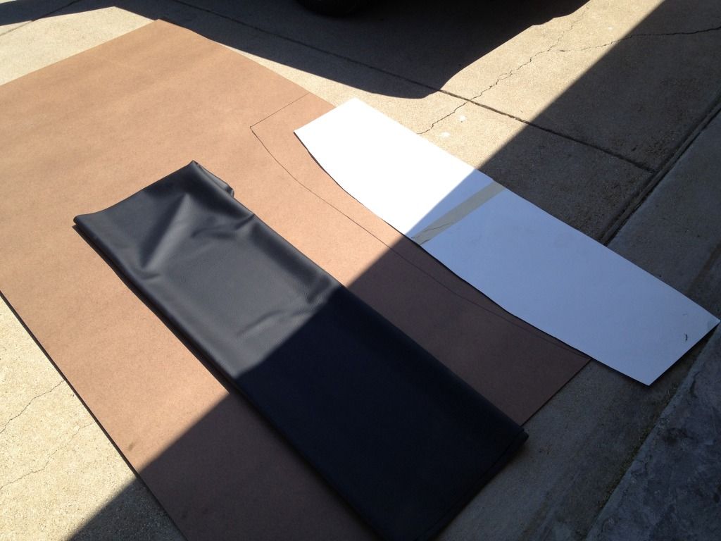

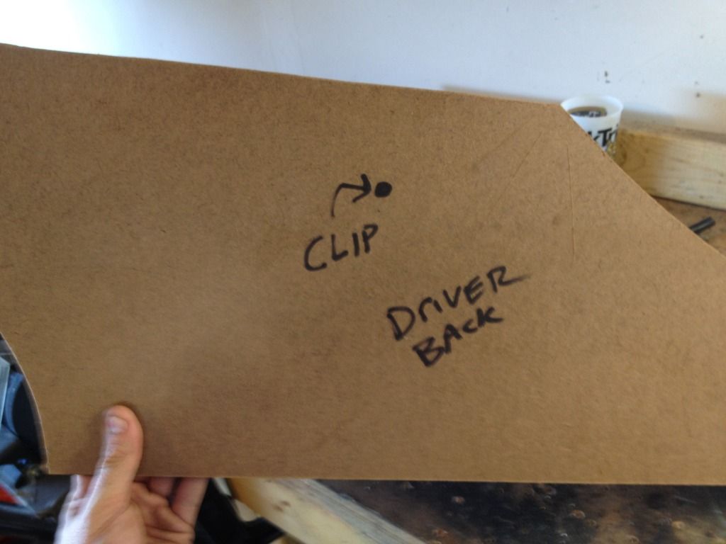

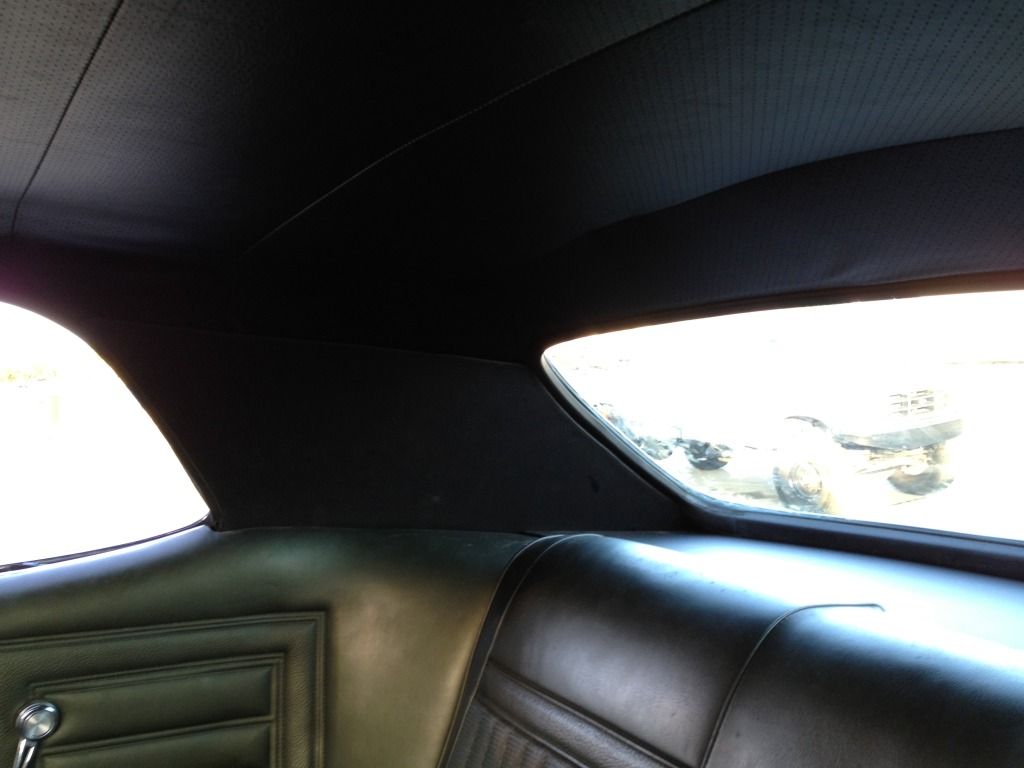

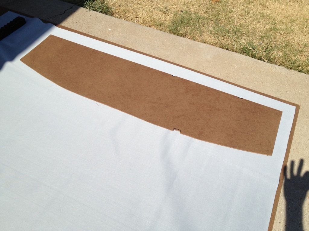

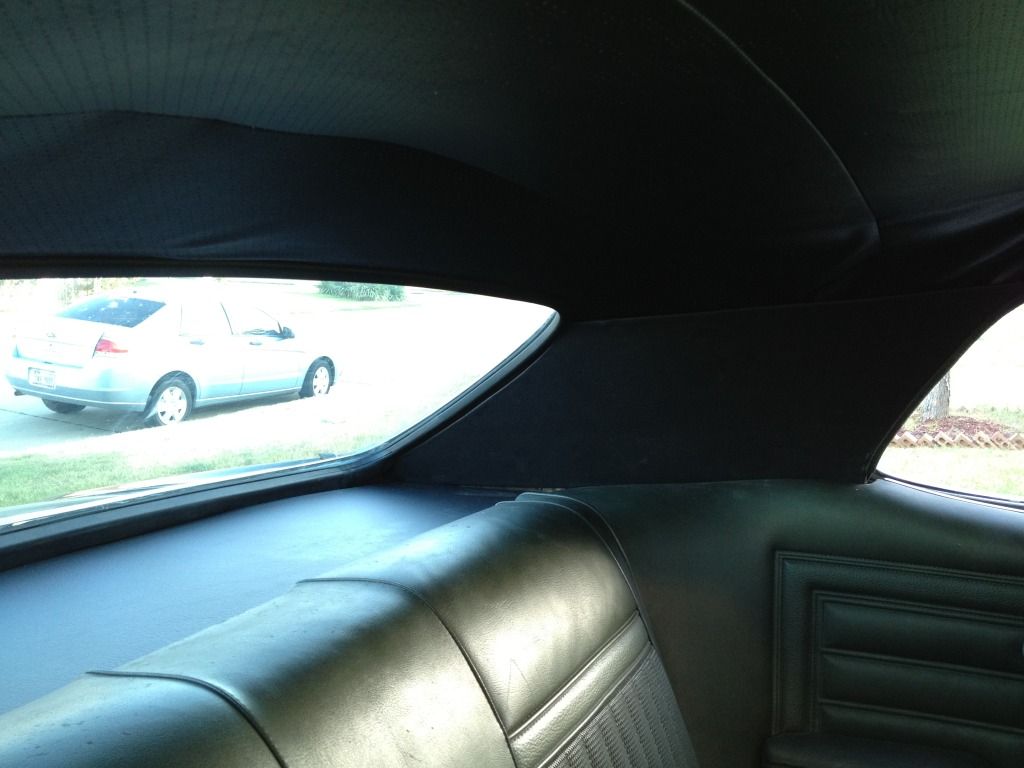

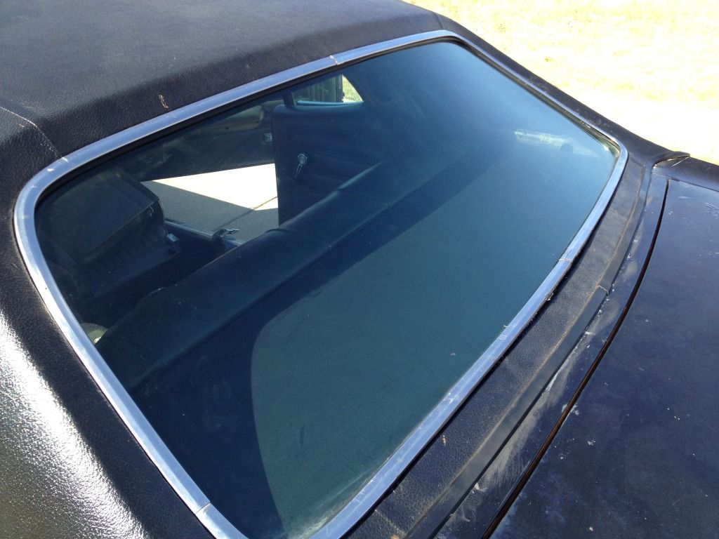

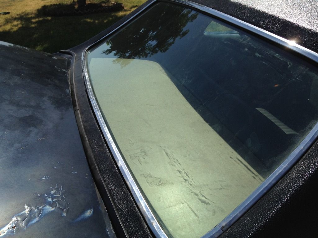

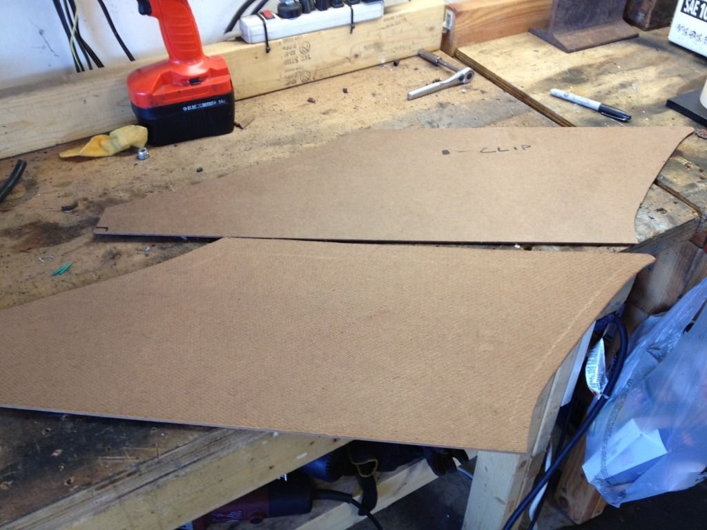

Next I tackled interior. The PO had put in a new headliner and the car was missing the package tray and sail panels. After hearing about how bad quality the aftermarket stuff is, I thought it would be better, cheaper and a learning experience to try and make them myself.

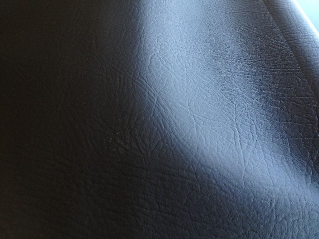

I headed out with my step-daughter Mia and we hit up a fabric store to get some vinyl. I got 2 yards at 6.50 a yard. Texture is nothing near original, but it sure will beat nothing that is back there now. I then went to the hardware store and got a huge piece of panel board for $8 something. I also picked up quality 3M adhesive from a local paint suplier.

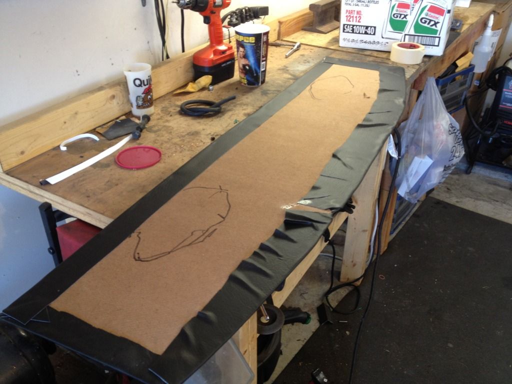

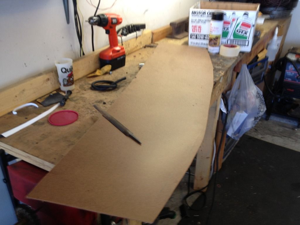

I didnt have an original package tray so I was tasked into making my own template.
The vinly in the hot sun made it easy to form.
That 69/70 body line in black is just stunning. Great job on the interior quarter panels, I just bought the new ones from WCCC. Can you spec out the wheels and tires that are on it? I just finished putting 245/50/16's on my 69, and I don't love them. I can't decide if I will end up going back to a 15, or up to a 17.
69 Posts
Thanks. The interior panels are fail, considering my first time, the sail panels are a little thick but seem to stay fine. I'll hack up the package tray when I get some new speakers for it. Seeing the bare steel was just bugging me!

Nice stuff man! I bet it quieted down a lot when you got the rear package tray installed. Looks a lot better with the sail panels installed. I accidentally left my Mustang GT floor mats in there. If you ever decide to get rid of em, let me know.
Yeah it is a litle quieter, it really needs some of that padding between the tray and sound deadening. But it looks decent for a homeade job. About the floor mats, you are welcome to get them back, maybe we can meet up halfway somewhere. They are soft and cushy, looks like a decent quality mat, so I understand.

sail panels are not a fail. you need to undo the front and back edges and wrap them under the windlace at the front and the back glass weatherstrip at the rear
69 Posts
Discussion Starter #17
Funny you mention, I was just looking at the aftermarket sails and noticed it had the flaps on the front and back. I was able to put the windlace over the panel board but it is tight.
I could alter them a little, thanks for the tip.

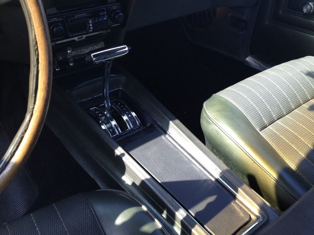

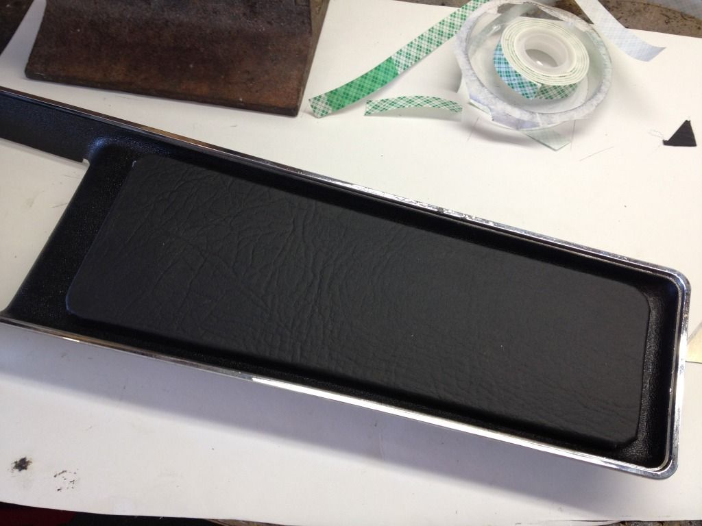

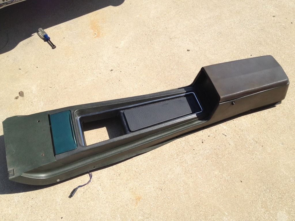

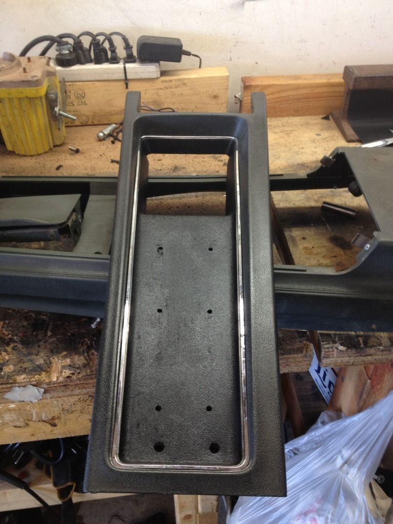

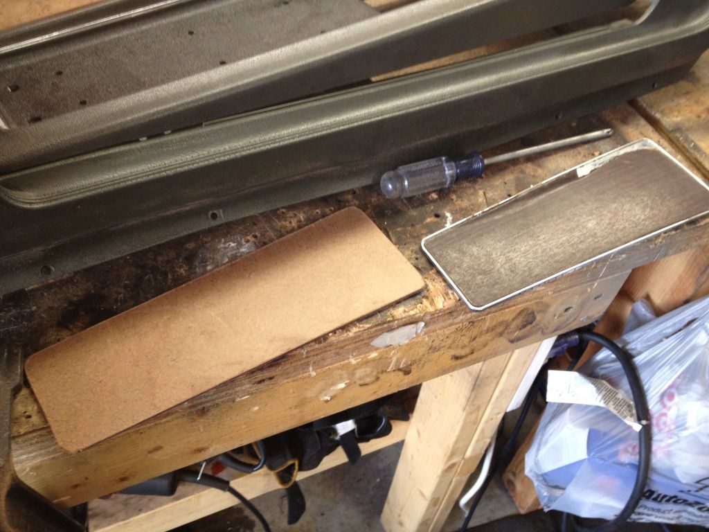

Did some work on the console. Cleaned it up a bit and polished the chome. Repainted the center black, and since my plastic wood center part was warped and cracked I made up one with hard board and extra vinyl.
Also polished up the hoos as good as I could, try to remove some of the oxidation.
