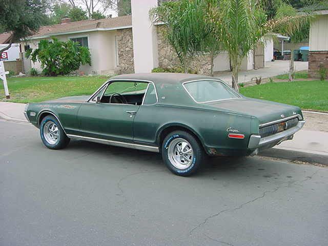

Meedle,
sweet ride there, looks great.
thanks
pat
6,980 Posts
This car has one coil cut off from a set of 1970 XR7 recycled coils.
