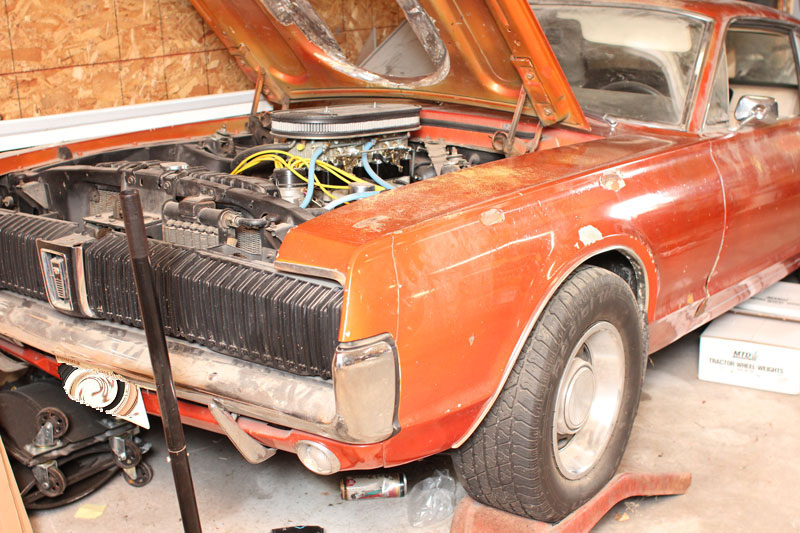

Here are some in process pictures of the installation.
These are the old pipes from the manifolds to the mufflers.
Mocking up the x-pipe.
X=pipe in place:
Mocking up the mufflers:
[img}
https://i.hmjimg.com/images/2020/07/01/909.jpg[/img]
Getting the tailpipes lighted up.
Final installation with both tailpipes attached.
