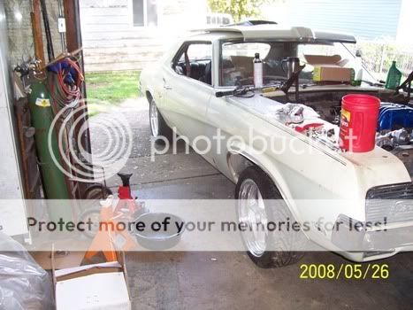

Hiya folks! I found lots of different links regarding tire and wheel sizes, but I haven't found anything for this specific set of wheels I am considering. Does anyone know if 17x8 inch wheels with 4.5" backspacing will fit under my 1970 Cougar? I'm pretty confident about the rear, but I question the front. I saw a different post that showed 17x8 with 4.75" backspacing working on the front - anyone have 17X8 rims on a 69 or 70 cougar with 4.5" backspacing?

Thank you for the reply! I appreciate it. I found that link, thats the one that list 17X8 with 4.75" backspacing working. Gonna bite the bullet and try it, Trickcat is making me feel better about it.

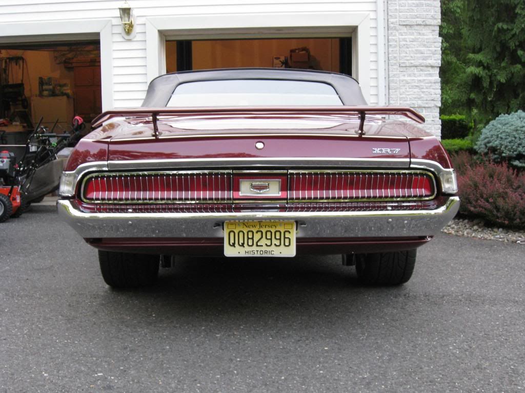

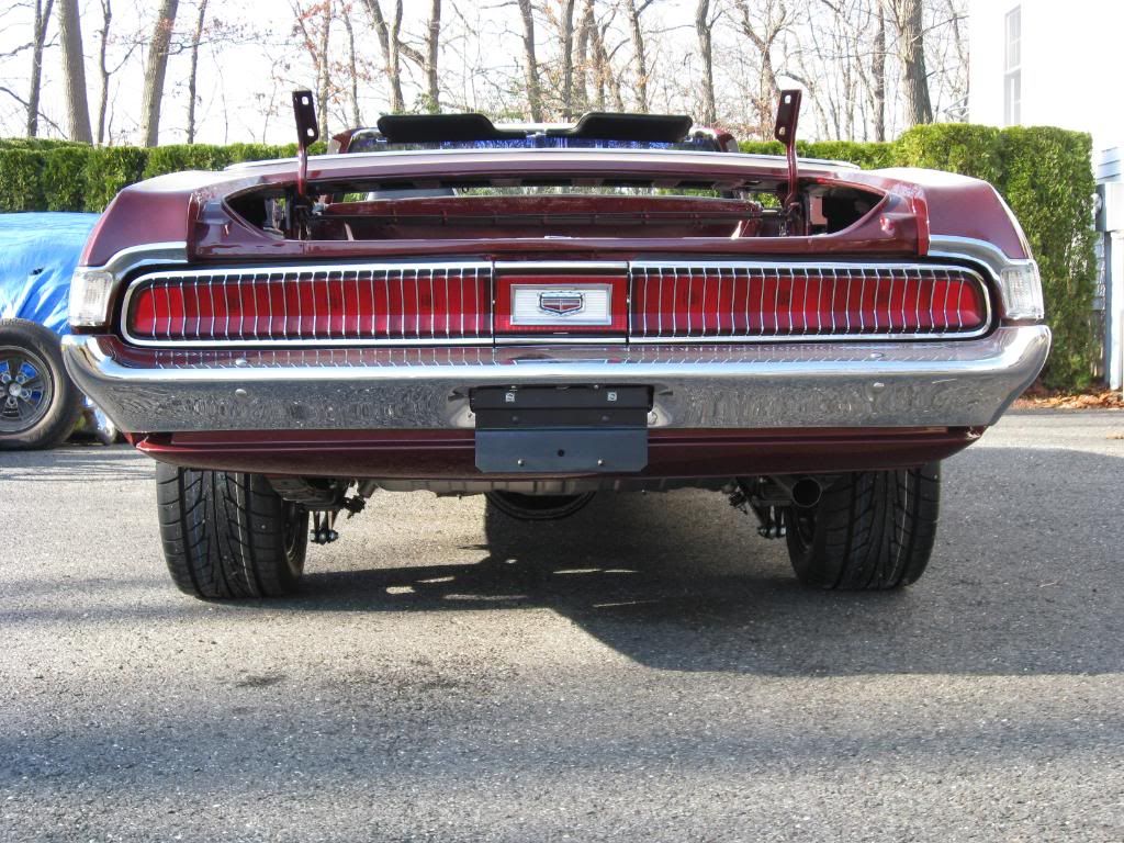

Hey Bob
Do you have pics of the rear tires ( from the rear)?
Absolutely.
This one is kind of dark, will post an earlier one too.
It is pretty much the fattest tire you can get under the stock wheel wells.

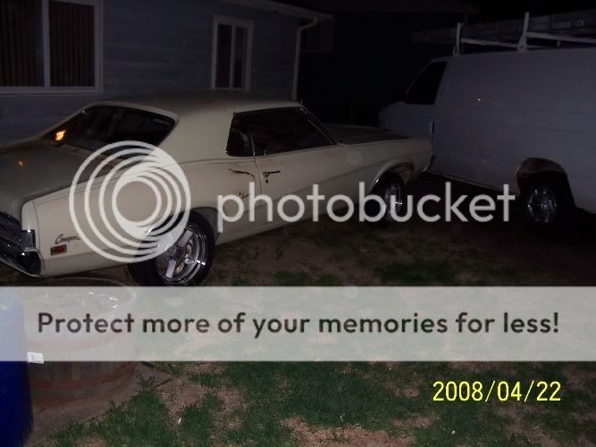

Update - I installed 17x8, 4.5" backspacking all the way around. 235/45/17 up front, 245/45/17 in the rear. No rubbing, no issues. Happy camper!
