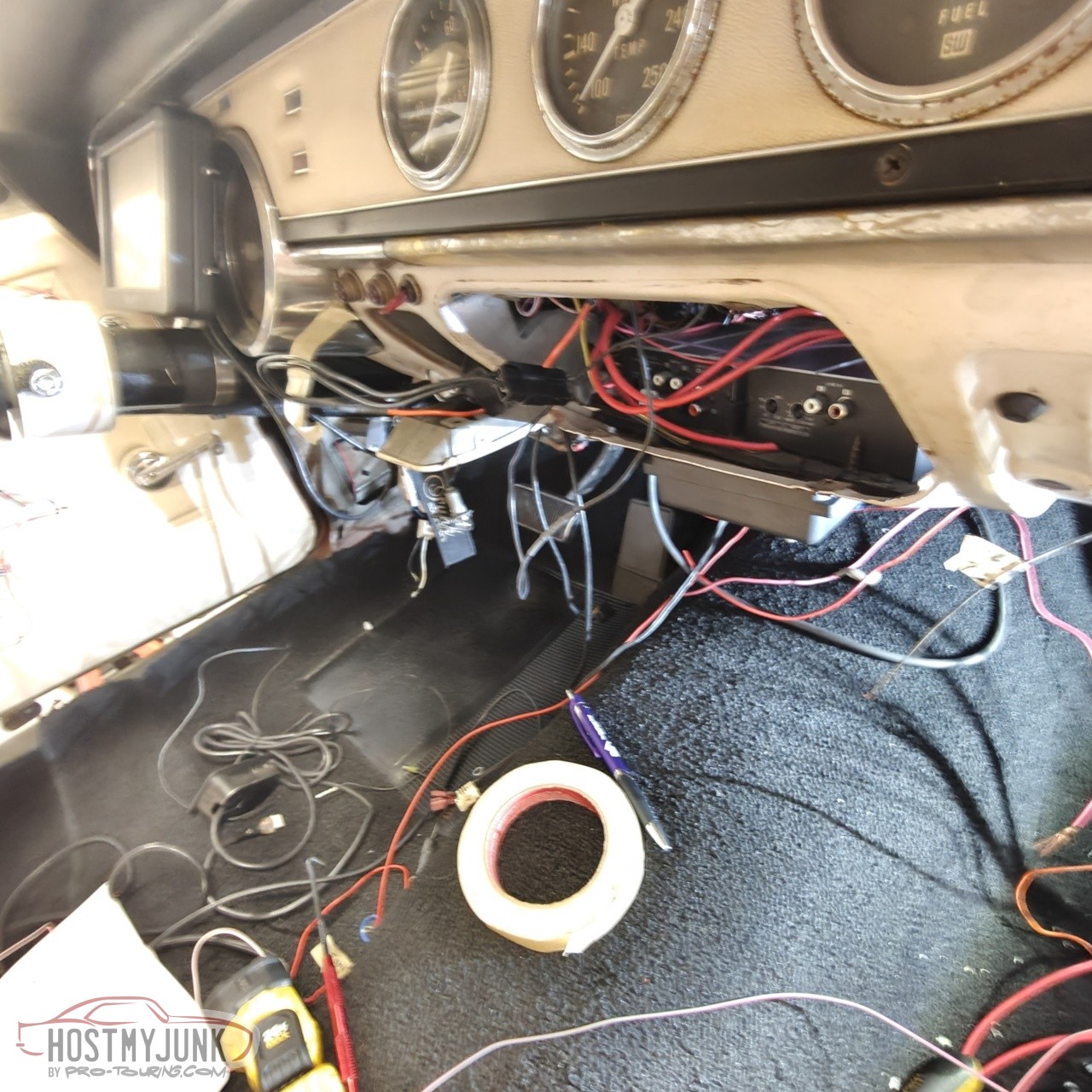

    Nothing like going overboard after being stranded for a dumbass 1 dollar fuse holder. I needed up ordering one of these guys from Waytek Wire:
    https://www.waytekwire.com/item/4632...AAAAC-PDM-AMI/
    The idea is to use it as my main distribution point for all my high draw items. I'll connect it with a 4 gauge wire directly from the battery. One of the leads will then go to my relay under the dash that gets energized when the ignition key is in the run and crank positions. That relay powers the relay for the fuel pump and also provides power to the Holley Digital Dash. Another lead will feed my stereo amps. A third lead will be left open for a future electronic steering upgrade, which is said to draw as much as 60 amps. The forth will be a spare should I need something in the future.
    Stay tuned...
