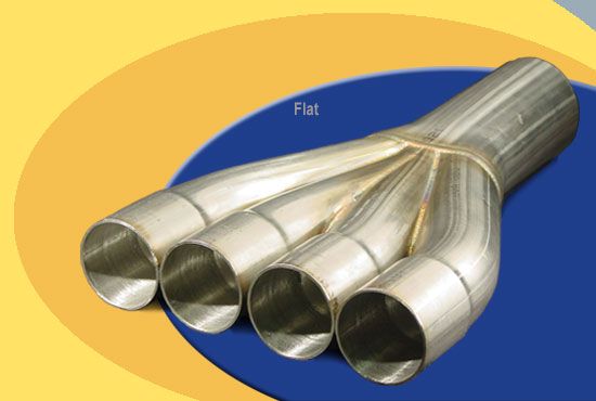

    I agree, a lot has gone on in 29 years, and I have always wanted to get back to finish her up, so I will slowly work on her as time and money allows. And it was nice to see I am not the only one in this situation.
    Here is the type of collector I was referring too for extra ground clearance. Then having the primaries re-routed to the higher position of the collector will give 2 more inches of ground clearance. And I will be also looking at maybe taking 1 to 2 inches out of the upper primaries to raise the collector itself if possible for even more clearance.

    Quote Originally Posted by 1967 XR7 GT View Post
    These are a great idea if there is sufficient horizontal room and you are making your own headers.

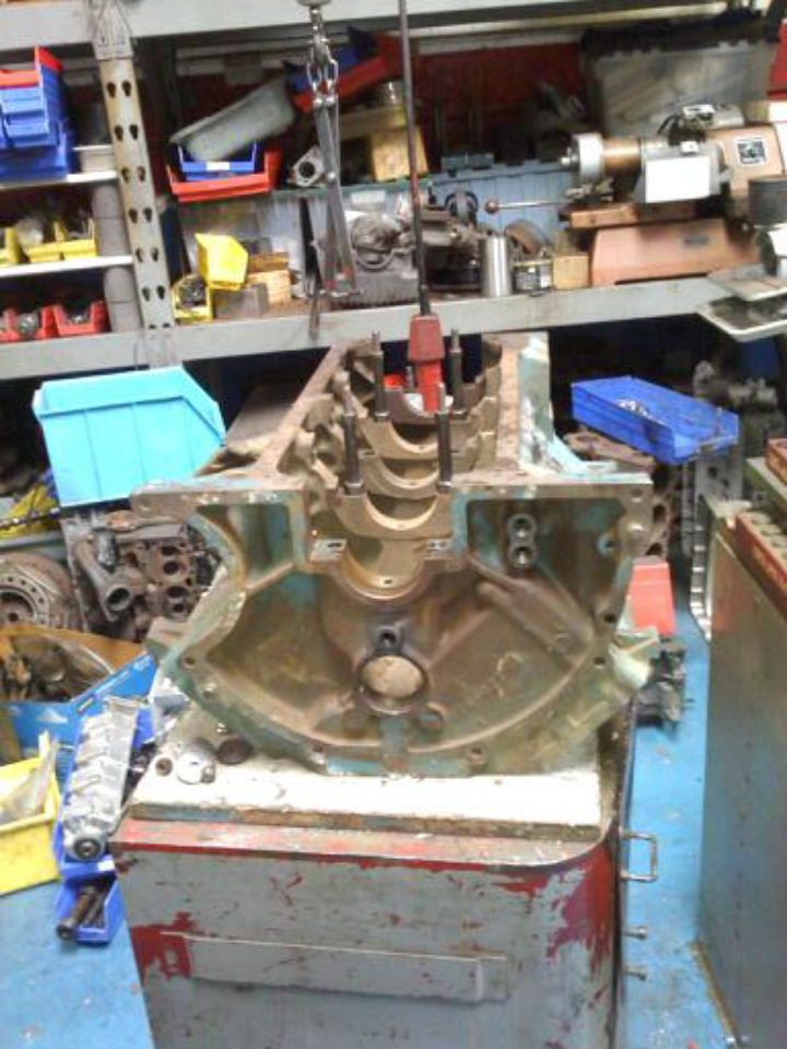

    I have decided to stay stock stroke, so I picked up an early forged factory crank (Pictured) for my SO build, this one comes with two additional center counter weights. From what I was able to find out, this crank came in the 64 427 HR and in the TBolts and is listed in the 427 7000 RPM Kits and was used as a Nascar Crank.
    I sent it to a crank shop to get a check-up and a clean up, and will post pics when I get it.
    I think around 450 Hp is more than enough, I don't really need any more, I just want it reliable with very little maintence, is the reason for not going a stroker.
    I'm going to use the car as a daily driver, so will go around the size of the cam I currently have in my 390, drop the stall to 2500 and drop the gears to 3.25's to 3.50's until I can afford a Gear Vendors Over Drive Unit.
    I am going to be looking for main bearings, and since the cranks mains are grooved the bearings don't have to be, but so far most I have found are, either fully or 3/4 grooved, and would like to find some that aren't. I know good luck.
